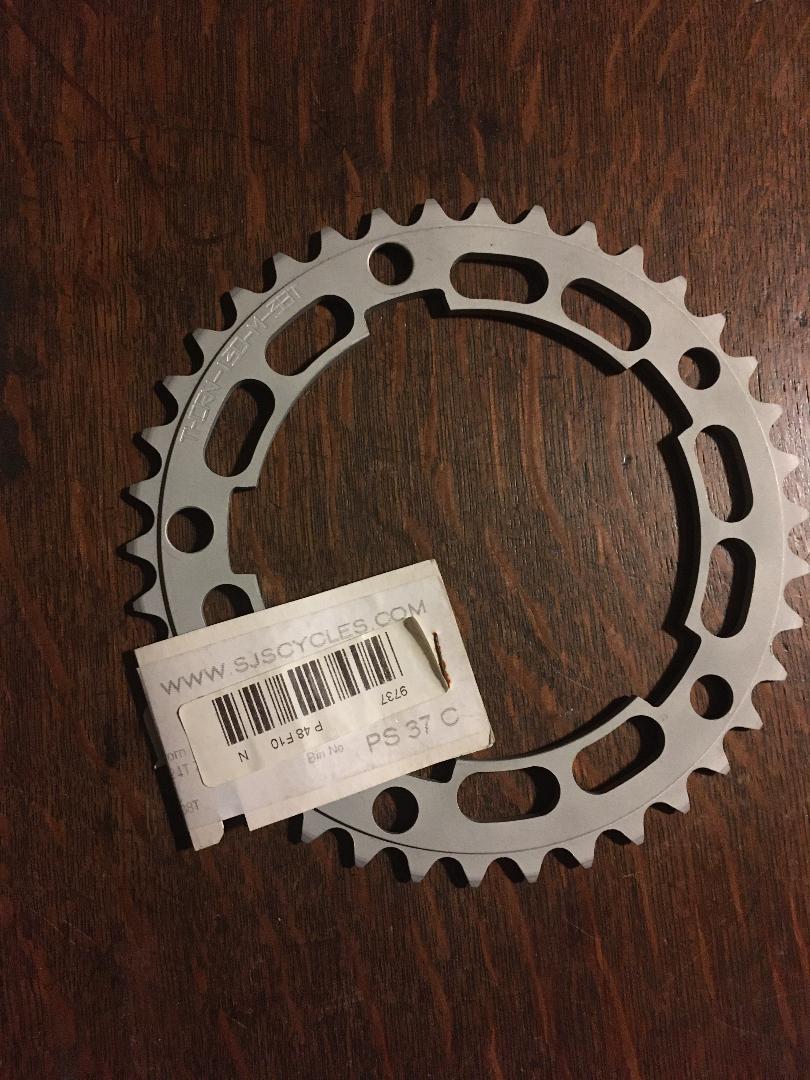

Martyn Aldis2025-08-03 12:03:33
Our Cannodale RT2 came with the same chain ring sizes you have Joanne and we found the low gears too high. I fitted a 26 tooth inner ring and this worked OK with the original FSA rings but when they wore out we had many major tangles with the replacement Stronglight and later Shimano rings.
More recently I found that SJS do a 130mm BCD middle that has a deep protection extension to stop the chain getting inside the middle ring when used with a small "granny" ring. This is working well now with a 24 tooth smallest ring. I have to change up from the 24t before going higher than cog 6 at the rear but that is fine, I go up to middle in rear cog 4 or 5 for perference. SJS say their special ring works up to 9 speed chain but we are getting good results with 10 speed chain.
