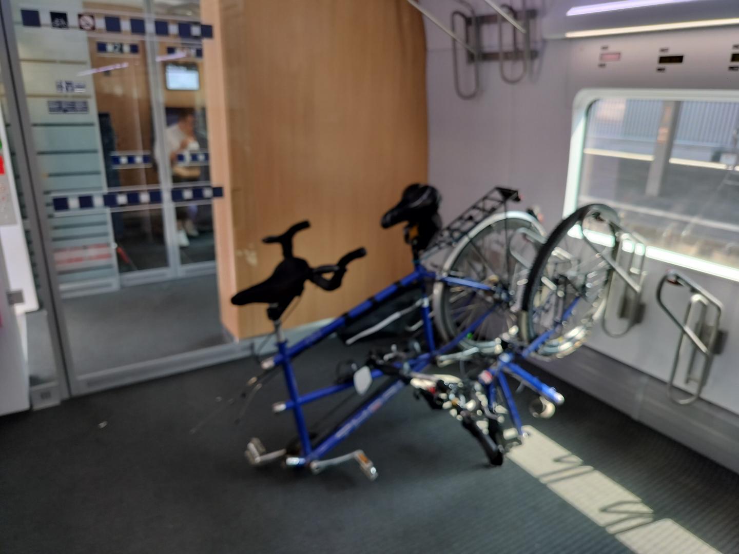

We bought a second hand Thorn tandem with S & S couplings about two and a half years ago. Having the ability to split the tandem gave us the confidence to take it on a train both in the UK and in the Netherlands. However on short rail journeys we had not been required to separate the two halves.
We are currently in the Netherlands and on this trip have taken two long rail journeys, firstly from Dusseldorf to Berlin and then the sleeper from Berlin to Rotterdam, on both of these journeys we would not have been able to do unless we split the tandem.
Prior to the train arriving we split the cables (we put the Rohloff into first gear beforehand just in case the gear selector was moved during the train journey) and loosened the S & S couplings half a turn. When the train pulled in, we wheeled the tandem to the bike carriage, remove the panniers and quickly split the frame.
Assembling is a bit more fiddly, and requires patience and understanding as you each think you are the one holding the frame in alignment while your co-rider is not. Make sure that the cable outers are correctly inserted into the frame weld-on lugs (and Rohloff users, make sure that 1st gear is selected before connecting the cables).
Having the S & S couplings has allowed us to use trains and given us the confidence to go further and be more adventurous, knowing that we could always get the train home if necessary.
